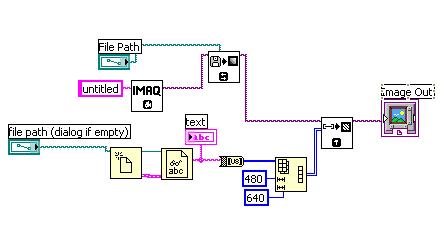

Hi Hasan,
sorry don't have it anymore.
But you should be able to program it from the image. The only thing you should know is, that the string constant is in "Code Display" Mode.

 😞 how can I search the Sub VIs present in image? how can i know them by their name :S
please tell me the 2nd component's name which is immediate after Open/Create/Replace File VI
thanks
Message 26 of 31
(1,537 Views)
Set file size. Inside advanced file functions

Mike
your code is working.... What I am doing is writing the spread sheet file of values that are coming in through com port. I have attached the file, but your code is not working for this file. what are the mistakes? how can i avoid "tab" delimiter? Please tell me the mistake that i am doing :S
Message 29 of 31
(1,506 Views)
Hi Hasan,
change "\s" to "\t".
