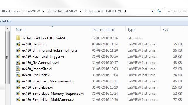

- The Thorcam application installer doesn't allow you to install the 32 bit version on a 64 bit machine, but the 64 bit version includes examples and dll's for 32 bit;
