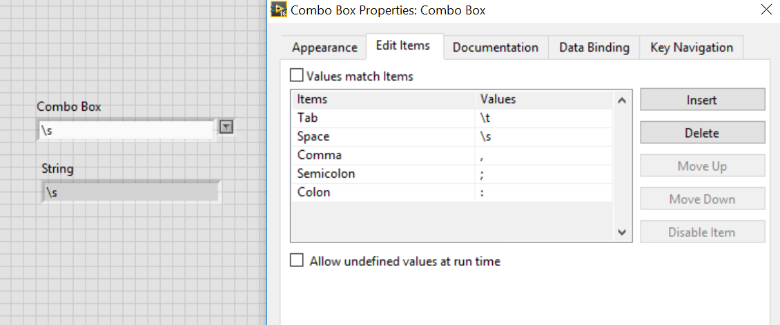

Why don't you use a combo box instead? This seems like a simple case where an XControl is overkill. The combo box might not be the ideal look, but it allows the user to select human readable text as a dropdown, but the text can still be "\" notation.

Assumed that a Combo Box could handle numeric values, only (besides the tags)

You're confusing the combo box with an enum. The combo box is 100% strings. The enum will always output a numeric, but can have custom naming attached to those numerics.
