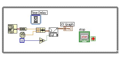

While we are waiting for the official word on this issue, this example may be useful.
It adds a new marker for every third update.
Ben
