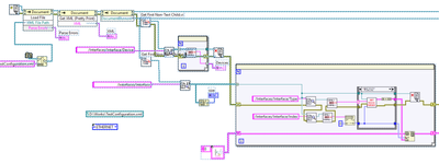

I have problems to get the requested informations from a XML File.
I use Lab View 2019 32 Bit.
The XML File contains the configuration of the different interfaces.
Depending on the interface type (RS232, GPIB, Ethernet) different parameters are saved.
Because Lab View does not maintain unions, an array of Clusters with all the possible interface parameter is created to save the requested parameters. If I run XML_Parser_2.vi, in the cluster Array are 3 times the parameters of the first Interface stored. If I add an additional Interface into the XML File, than the result cluster array contain 4 x the datas of the first interface. This fact I can not understand. How can I get the reference of all the interface from XML File into an Array? Or how can I step from first interface reference to the next and so on until the end is reached? Does somebody has an idea how I can solve this?
With the upper small for loop I get all the device of interface from XML File. The for loop at the bottom does not work as required (but without any errors).

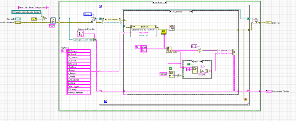

Here's an example of my test rack config file

The path of all my XML tags is clear, concise, easily parsed and mapped to a cluster.
Test_Rack_Configuration.AC_Source.Type = Ci5001
Test_Rack_Configuration.AC_Source.VISA = TCPIP0::192.168.0.7::inst0::INSTR
Test_Rack_Configuration.AC_Source.Vout.Max = 300
Test_Rack_Configuration.AC_Source.Vout.Min = 0

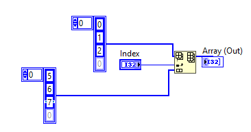

The "Insert into Array" function fails silently when the input index is out of range of the input array. Play around with the "Index" to see it in action:
The solution would be to use "build array" instead and keep track of the index in another way.

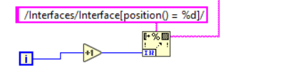

I have noticed another possible error (I can't check, I can't open your files):
Your XPaths inside the loop should probably be "./Index" and "./Type" instead of the path from the root. Check https://en.wikipedia.org/wiki/XPath#Axis_specifiers

Thank you very much for your post. I attach the files unzipped. Because it was not possible to send the XML File TestConfiguration.XML I added the content of this file hereinafter.

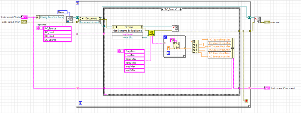

I would simply have AC_Source_0, AC_Source_1...etc.
I do my XML Parsing a little different. I search for the XML tags by level and put the value returned into a cluster.

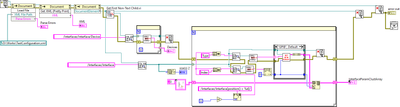

I found a solution to my difficulties. Although the bigger for loop steps trough all the Interface references, the Get First Matched Node.vi always give the reference of the first Node back.
With the changed XPath String
in the for loop, the Function of the VI works as requested.
Thanks to all which helped me to find a solution!
