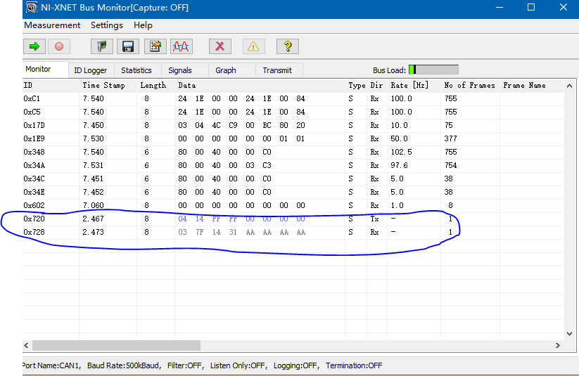

hi, I have a question about the XNET CAN UDS.  In XNET But Monitor I can send and receive the ID and payload of UDS.  But I cannot receive the payload in my labview programm?

Your VI does not have the default values saved on the control. Did you send the correct ID and payload? You can run Bus Monitor in the subordinate mode to troubleshoot your LabVIEW program. See Log Bus Traffic with NI-XNET Bus Monitor While Running NI-XNET Application
