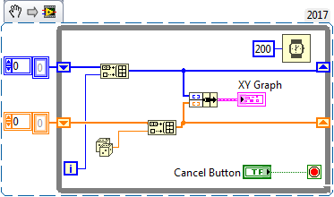

Close, but you are trying to plot individual values, since your shift registers never build up arrays..see example.Shift_registers_arrays.pngShift_registers_arrays.png

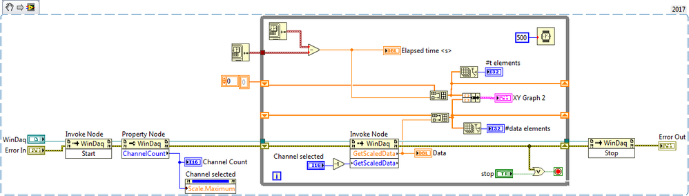

Hi Cstorey, thank you for your input!
I think I understood the concept, I tried editing the code 2-ways, one with shift registers and 1 with express vi's (having unchecked the clear data box). I have attached 2 sniplets, they seem to work, but I would appreciate a second opinion in terms of obvious rookie mistakes I might have made 🙂 (the 2 array size icons are only there for my sanity check)

Ok, you grasped the shift register plotting concept well but there a lot of simplifications you can make.
1 - avoid sequence structures, use dataflow
2 - no need to double convert timestamps, the subtract operator does that for you
3 - elapsed time calc was wrong
4 - add error handling

Out of curiosity, are you using a local variable (to the left of the shift register's input)?
Message 8 of 9
(5,518 Views)
That's not a local variable, it's an empty array constant.  It's used to initialize the shift registers as empty before the loop runs.  That way the plot is cleared each time it executes.
