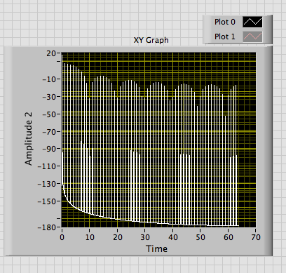

It can be done, bu it may not be trivial, depending on how automated you want it to be.
First, create a duplicate scale.  See the LV Help page titled Adding Multiple X- and Y-Scales on Graphs or Charts.
Next, calculate the values in dBm from the range in the data or the range of the instrument.
Use property nodes to set the properties of one scale to display the dBm values and hide the other scale.
Here is a little example which shows what I tried.  Some of the things in there may not be needed.  This is not optimized.
Lynn
(4,110 Views)
