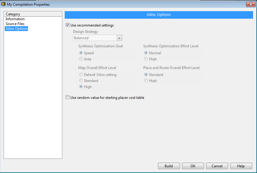

Interesting, are you looking in the correct place for the compiler options? Compiler options aren't going to be located under "FPGA Target Properties" as you mentioned previously (sorry I missed this in your first post), rather those options are located under the "Xilinx Options" category when you create an FPGA build spec for compilation.
Right-click on Build Specifications » New » Compilation, then select the Xilinx Options category and you should see a window like this.
Can you confirm that you are looking in this location?

Thank you sir for your valuable reply. I was looking at wrong place. Now I find it under build specification. Thank you again.
