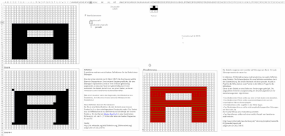

Once ago, I wrote a skeleton algorithm based on Zhang-Suen in LabView for binary images represented as a boolean 2d array
but I can't find the .vi right now.
Also, this would need some modification for thinning.
off topic:
I remember that I prototyped this skeleton algorithm in EXCEL
ironically, that .xls file is sitting an my hard drive

@Eggord wrote:
@alexderjuengere: Did you remember how you implemented it? Did you use
IMAQ Read Pixel Value From Image to get the pixel values? This sounds quiet messy to program it in Labview. I'm happy if you or 🙂
in IMAQ, there exits some skeleton functions.
https://www.ni.com/docs/en-US/bundle/ni-vision/page/advanced-morphology-operations.html
I don't know, if you could mod those IMAQ skeletons to do thinning -
In my demo vis attached, it is just plain LabView 2010 x32.
Furthermore, I figured out the modification to change from skeleton to thinning...
(4,532 Views)
