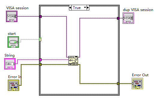

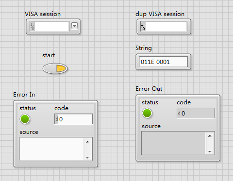

Based on page 7 of the Application Guide, I would do something like this.
NOTE: I have the String To Write to use the Hex display (forgot to show that on the front panel).
Message 4 of 8

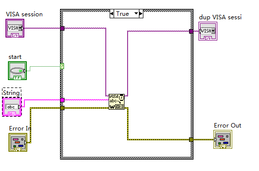

yes you're right. I read the manual and understood the string you posted.
can I write in this way?
Message 7 of 8
(4,915 Views)
As long as your input sting there is showing the Hex display, I'd say you got it.
