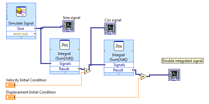

I have an acceleration signal
I can integrate it twice using Labview VI as shown in the attached file in order to find out velocity and displacement signals.
But how do I calculate the INITIAL CONDITIONS for velocity and displacement????
And how to include such initial conditions in the VI

You can't calculate an initial position or an initial velocity.  You have to define them.  Do you want to assume your object is as a position of x=0 and a velocity of zero when you start acquiring data and integrating it?  Or do you want to assume it is at a position x0 and/or already moving at a velocity V0 when the acquisition starts.

Hi Sehgal,
get rid of the ExpressVI, use "real" VIs/functions from the palettes instead and you will be able to supply start conditions to your integration...

These initial conditions are relative offsets to the results of each of the integral operations, ie
The result of the integration of the acceleration signal is your velocity distribution, which is relative to the initial condition 0.2 to t=0.
The result of the intergration of the velocity distribution is your displacement distribution, which is relative to the initial condition 0.3 at t=0.
Therefore, just add the initial condition to the distribution.

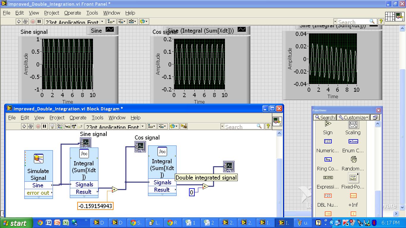

Thanks a lot
But I tried it and got a problem that the displacement signal is drifting downwards. It should be a sine wave but it is not coming like that. Please see the attached VI file for details. Here acceleration signal is of 1Hz frequency. Pic.JPG

Hi Sehgal,
did you read my message #4?

Of course it is. If you intergrate a sinusoidal signal with a non-zero meanline then you will see shifted result biased towards that meanline. Therefore, if the centre plot has a meanline of -0.159 (as dictated by the initial condition), then the integral result will slope downwards. This is an expected outcome.

Hi GerdW
I have tried that also but the same problem persists......the double integral drfits downwards as shown in the third scope
Can you please send the VI file to me...I will be very thankful to you....i have already spent 50 odd hours on this problem.
