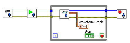

Hello guys!!
I would like to plot the waveform from a sound of my sound card (using the microphone).  Well, with the "acquire sound" icon from the Express menu I could make it.  But I have a trouble when I want to store as a binary data.  If a set the "acquire sound" icon in 1 channel, I have not problem to store and plot then, but when I set the "acquire sound" icon in 2 channels, I can to plot the binary data.  I attach a picture with the vi
Can someone help me please?
thanks

I wouldnt recommend the Express VI.
You just need to do something like this:
Only the Read needs to be in a loop.
Remember to put a wait in the loop.
The data output is an array of waveforms, so you can write to a file if you want.

Sorry, but it is not the problem.  I only have been using the "acquire sound" cause I need to simulate severals channel and then can to store in a unique binary file with two columns.

I think you should modify the "Sound Input Read VI" as shown in the picture. Remember to save it some place else than the vi.lib dir

Sorry guys, maybe I made the wrong question.  I just used the "acquire sound" to simulate several signals.
What do you think about this solution???
Very close to ending up here
http://forums.ni.com/ni/board/message?board.id=BreakPoint&thread.id=2634&view=by_date_descending&pag...
try to understand this
Do NOT use Express VIs. Using Express VIs is like peeing in your pants a cold winter day. You may get warmer for a few minutes. But after that it will be very cold.
