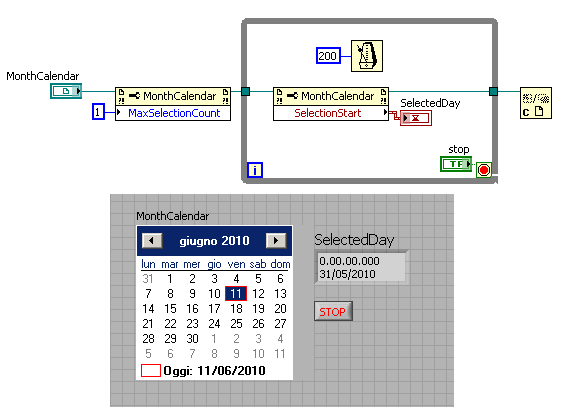

As a starting point you can give a look to this thread (there are examples for the MonthView calendar ActiveX)
http://forums.ni.com/ni/board/message?board.id=170&thread.id=327119&view=by_date_ascending&page=1
Marco
Message 2 of 10
(4,951 Views)
An example on how to get the selected data from the control:
