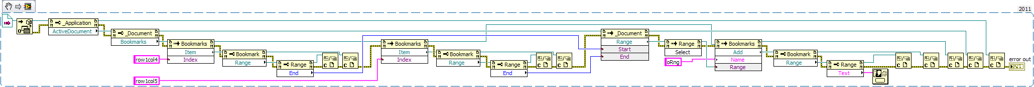

This snippet is pretty much a direct translation of the VB code into LabVIEW using ActiveX nodes:
EDIT: by the way, in case you're unfamiliar with snippets: you can drag this image directly to the block diagram of a LabVIEW VI (for some web browsers, you may need to drag it to the desktop first, and from there into the block diagram).  I can save it for an earlier version of LabVIEW if necessary.
Message 7 of 11
(5,955 Views)
That snippet was exactly what I was looking for Thank You, but...it doesn't work.

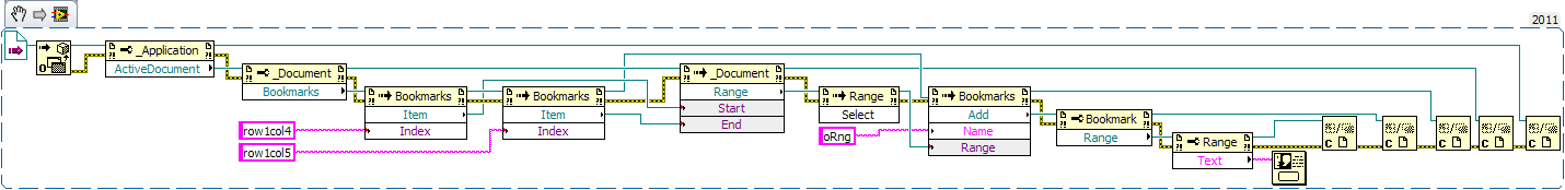

Hey, I didn't say I'd tested it!  (If you upload your Word document I can give it a try).
If you run the LabVIEW code with Execution Highlighting turned on, do you see an error from any of the ActiveX nodes?
Message 9 of 11
(5,941 Views)
Accepted by topic author DL_LEO
Found the error - sorry, I didn't copy the VB code carefully enough and I left out a few nodes.  This one works (I tested it).  I don't see the selection get highlighted, but the message box contains the correct text.
EDIT: oops, still one minor error - your VB code uses the Start for one bookmark and End for the other, I used End for both.  If you want an exact match, just change the property from End to Start for the appropriate bookmark.
