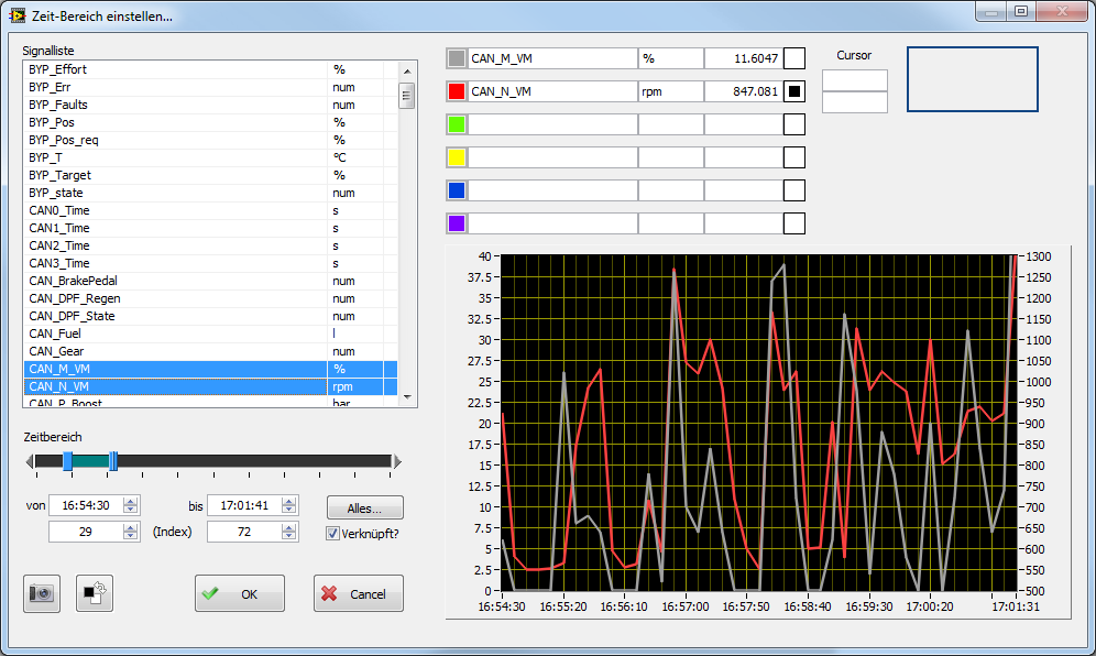

I prefer listboxes: much easier to handle, for both the programmer and the user:
In the listbox on the upper left the user can select signals to view them in the graph…
