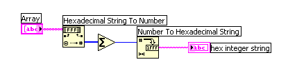

Thanks but I did not explain myself fully ....
I have strings in hexadecimal format in this 255 string array. I would like my outcome to be converted back to this string function. I am looking to just send my full array in an get the element out.
(3,631 Views)
This should do what you need. You'll find the conversion functions in the "String>String/Number Conversion" function palette.

Thanks that is exactly what I was looking for
