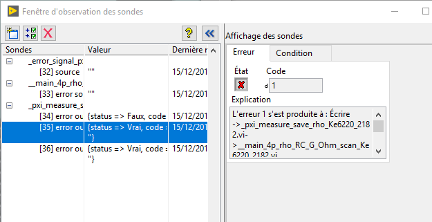

Hi
After 20554 seconds of working properly, both express vi throw an error.
No error before entering Express.vi. Is win10 locking files ? Antivirus ?
Clueless.

Hi
I found out finally what was the problem :
-There was one error in a device before the WriteExpress. after the error boolean input in Write to File express.vi is TRUE, the express does not work anymore.
I am not sure this is how it is supposed to work. Here is a short vi to reproduce this error.
After starting, the program saves a random number to a file for every half a second.
Change the state of Error in boolean, you'll get a Error in th output of the Write express (code 0).
Then Remove the error in the input.
Write express gives error 1 even though (apparently) there is no error in.
Regards
