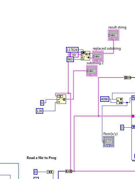

Hi there,
So my string has a data size(hex code) of 117824. Now I want to make it of size 118784 so that it is perfectly divisible by 4096. So basically what I want to do is add zero paddings to the empty strings until it reaches 118784. I tried using replace substring but couldn't get the expected results. Thanks!append.PNG

I tried using this approach instead but the output was 3030 3030 3030. What I wanted is 0000 0000 0000.

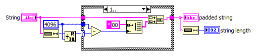

Padding a string can be quite easy:
That's because you don't know the difference between a byte with value zero and the ASCII char "0"…

Hi GerdW,
May I know why are you using case structure? Also could I have the vi file (preferably in 8.5). Thanks!

Hi keatwk,
No need to add 4096 bytes in case the string already has a proper length…
Unfortunately I didn't save this little item. It's easy enough to recreate it from scratch - and a nice exercise for you to learn LabVIEW with…

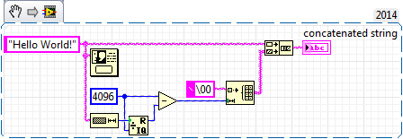

@keatwk wrote:
Hi GerdW,
I'm assuming the case structure is for readability.  Initializing an array of "Remainder" number of elements and concatinationg that too string should work just as well without the case structure.
Backsaved to LabVIEW 8.5 attached

Hi keatwk,
did you notice the display mode of the string constants in my and Jeff's example image? There's a reason why we explicitely show this setting!
@Jeff: Is there a reason to add 4096 bytes to the string when it happens to have a length dividable by 4096?

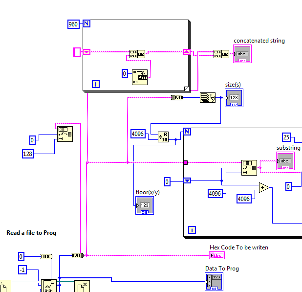

This looks like it is related to this thread here
http://forums.ni.com/t5/LabVIEW/split-hex-code-after-every-4096-bytes/td-p/3212543

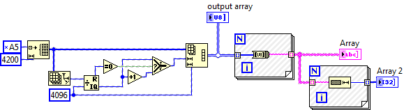

If you look at my example that I posted you end up with 4096 bytes padded already in one operation...
Craig
