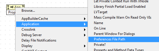

I have looked in LV2011 and 2012 for an application property node call App.PrefsFilePth.  I know it exist and can get it by opening a VI that already contains it.  Can someone tell me what I need to activate or add to my INI file for LabVIEW so that this shows up?  See attached snippet

Check this.
Edited: After adding those two keys in the LabVIEW INI, you'll be able to see all hidden property/invoke nodes.

Geez, I thought those lines went out the door when LabVIEW officially supported scripting.
"SuperPrivateScriptingFeatureVisible=True
SuperSecretPrivateSpecialStuff=True"
Paul
(2,906 Views)
The first line did.  The second line turns on a bunch of private stuff that is totally unsupported, may not be implemented, and could crash LabVIEW and corrupt your code - all of which have happened to me over the past few years.  It sometimes contains things which should be public (in which case, please let us know).
