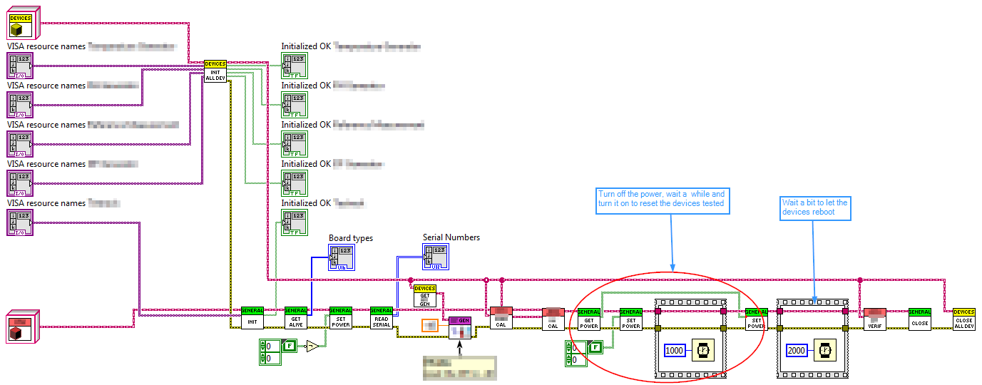

For my current program I want to test devices. At the moment my code is the flat structure in the picture below.
Current test program
Even tough some steps are relatively short (set power), some other steps are way to long (+5 hours) to keep in the current form (... cal and ... cal) (before the red circle). So even the fact that this program is great for testing/debugging if I give this to a operator they'll probably gona hate me or something.
So my question is: what is the best design pattern to convert this "blob" to a more usable form. (On a side-note: I know of NI teststand but a "full LabVIEW" solution is required.)
So far I looked at the queued message handler and the model view controller design patterns and the model view controller has at the moment the best chance of succeeding but I really would like to know if there are other/better design patterns to accomplish this task.

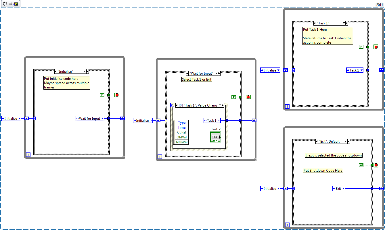

For example if you can only do one task at a time, and they are relatively quick (like the turn on power you mention, but not +5hrs you discuss) then convert your program into a state machine. They've been mentioned here a lot and are probably the most widely used/standard programming technique. If you aren't familiar with them this is the basics right here:
The snippet above shows a very simple version of the state machine - you can put the actions in different panes of the conditional state structure. There are lots of other ways to do this too - and a lot of things you should do (like add in an error handling page and similar). Using this you can put the 'red circle' part into different pages on the state machine and the user can select them as he needs to.
However if the tasks you are talking about take a long time but can be run asychonously then I'd suggest you use an event driven producer consumer loop (lots of literature on this too). In the consumer loop I'd dynamically start the sub-tasks in separate VIs (using the run asynchronous command (apologies for my spellings)) or something similar. This would allow the user to start the tasks and run a number of of the long ones in parallel without locking up the UI. If you go with this appraoch it will be important to track what parts of your code is running, check the status of the tasks and block the user from doing things which may be dangerous and so on (starting a new Task#1 when Task#1 is already running etc). Thereore user-events (to update your UI) will also be important.

Oh...and in the VI snippet, the second enum in 'Task 1' page should be 'wait for input'....otherwise the code will repeate Task 1 again and again.....shoudl've debugged;-)

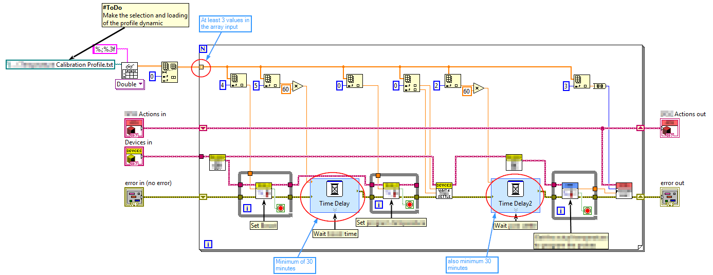

For your enterainment Smiley Wink I attached the 1st .... cal procedure from the 1st image. And Yes I know that I have to remove the "time delay" blocks from the block diagram. Asside grom the delay in these blocks the "wait 4 ... settle" also takes a long time to finish.
