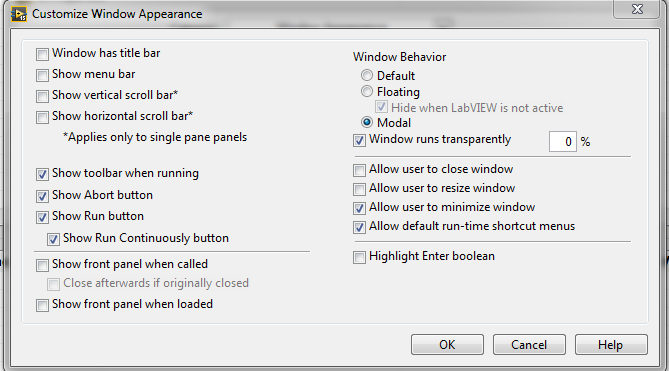

In the Properties uncheck window has title bar and check whether it works for you or not...

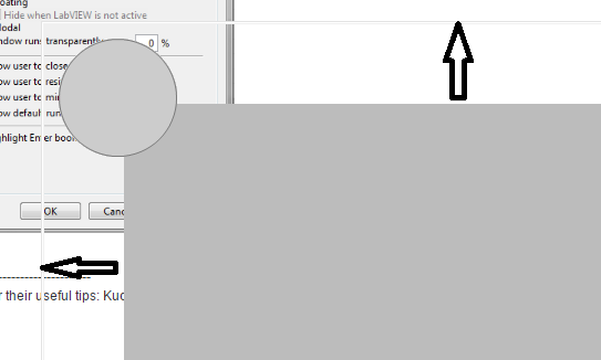

That is not the case, see image below:
Window is transparent so I can have customised shape.

Thanks for reply.
I have checked that example. Everything works good until I set this window as modal. When window is modal I see frame around my transparent window that looks bad.
