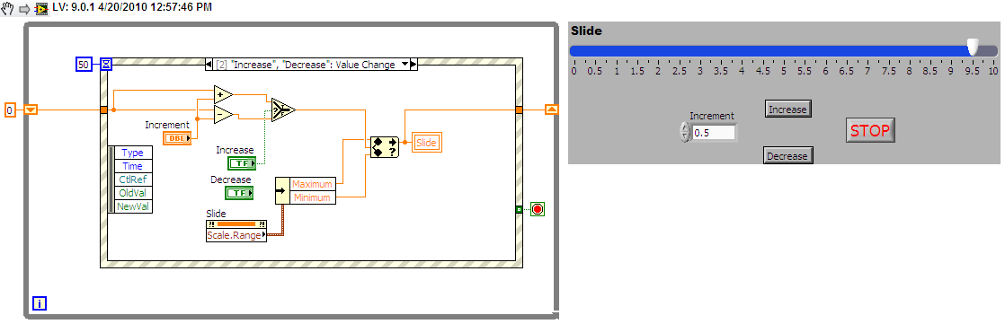

You can use an Event Structure with a Local Variable.  I added the In Range and Coerce check to prevent going beyond the limits of the slide.

Please,what is the name of this icon between unbundle by name and  the  slide ?

In Range and Coerce
That image is a Snippet.  You can drop it onto your Block Diagram if you're using LV2009.

could you help me?
My VI only increase but not decrease the slide.
two events are ?
where is the difference between the increment event and the event decrement ?
I am sending the vi.
Thank you
Juscelino.

Hi Juscelino,
"two events are ?"
Don't know what you say here...
"What is the difference..."
The point is: both are same (more or less). When you want to decrease a value you should use a subtract instead of a add function... Just use proper debugging using the highlighting tool!

solved. thank you very much.

I adjusted your code Try this. I have both increase and decrease in the same event. There is no reason to have both.
