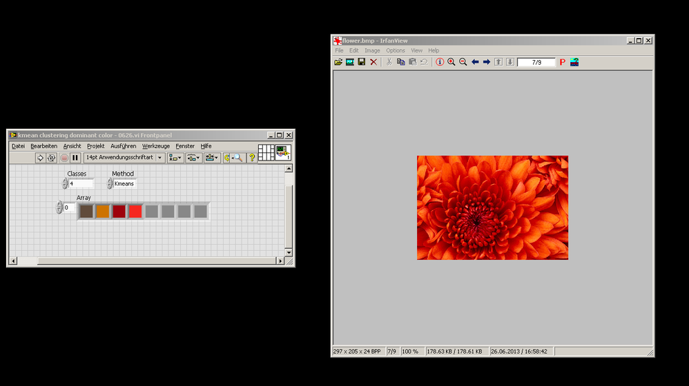

here's a quick and dirty draft. the "color ramp array"  contains all colors which occur in the input image
now, implement an algorithm to get the dominat colors from the color ramp array!

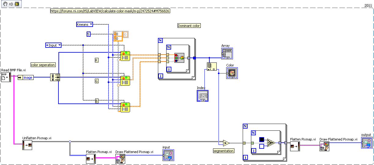

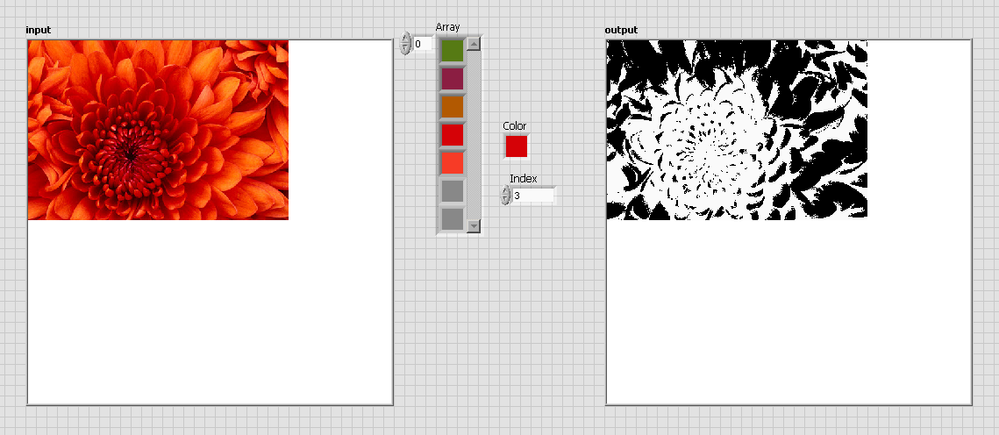

Accepted by topic author Madhubalan
So, you use the "dominant color" as a threshold for segmentation.
Message 8 of 31
(5,447 Views)
