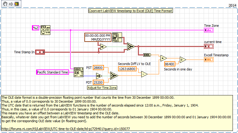

Instead of writing a time/date string you should write a double precision number that corresponds to the OLE date that Excel uses.
Now you will find when you open your Excel file the time column will look like a crazy number, simply format the column to the time and/or date format you desire.
You will find that you can now do a running subtraction to show the time between time stamps in Excel.
