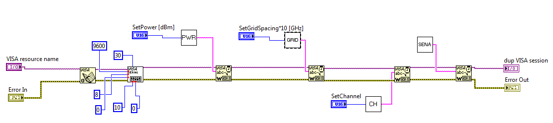

can't open session.....don't know where is wrong
select a single laser channel:
there is no wavelength output.....I don't know where is wrong...it just doesn't work......maybe the session is not opened???? or the command format I wrote is wrong?
I don't thinkg I miss something....but I just don't know where is wrong........sad

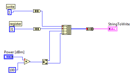

why those conversion dots. you are multiplying a U16 to a constant ( 100, which i guess I32 ) which is not giving you correct datatype. Try making that constant into U16.

Simple question, are you sure that your communication port is close before you try to open it ?

You dont need multiple VISA write, instead you need to combine all the data which you need to write at once and write.
