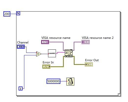

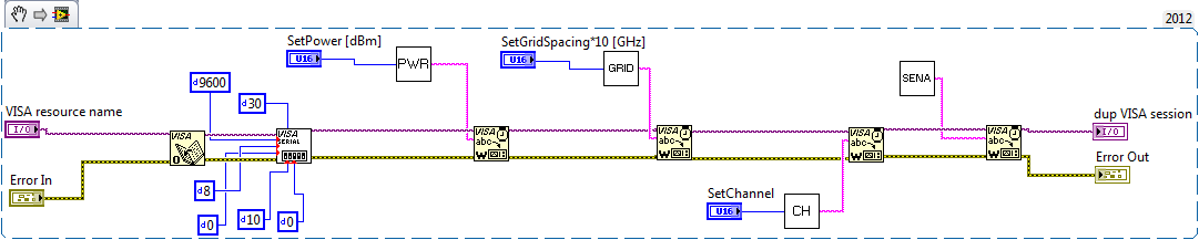

I used the optical spectrum analyzer (OSA) to check the result, but it didn't work. there is no output wavelength. maybe there is something wrong with the initialize and configure parts? Can anyone take a look? did I miss something?

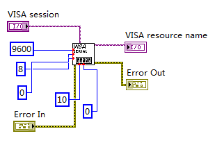

Initialize: it is serial port.

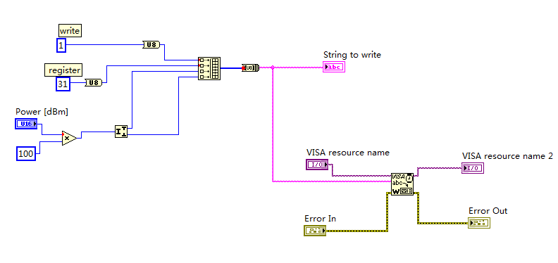

configure_SetPower: set the output power of laser

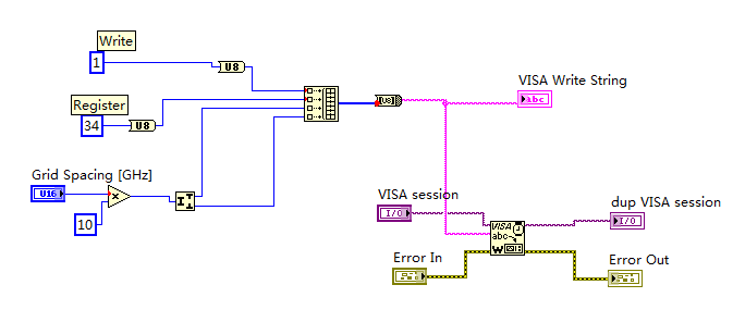

configure_SetGridSpacing:set the spacing between every two channels

I believe the issue may be that you are trying to access the resource many different times throughout your code, but never open a session. You should open a VISA session, and use dataflow programming to make sure only one string is being written to your instrument at a time. I have attached a template for basic write functions when using VISA. Make sure you open and close the session as appropriate. This is a VI snippet, you can drop this .png into the block diagram and it will populate with the shown code, which you can use as a guide in modifying your block diagram. I hope this helps.

You register value, is that in hex or decimal number ?
The format of the frame is having hex ranges.
If it should be in hex then you are sending  register 1Eh (30d) and not 30h.

Post snippets of your code ( Menu Edit>>Create Snippet)
For ALL of your block diagram constants that are integers show the radix! (Select the constant Right-click)
You most likely have just found your own problem after doing that and selecting hexadecimal representation.

Hello, I created the snippet as you said.
the constant are all decimals I think.
but the output of the sub VIs (PWR, GRID,CH and SENA) are all hex display.
what I don't understand is no matter it is hex display or normal display, I think they are just different ways of display, but they mean the same to VISA WRITE.   or the VISA WRITE only accept hex numbers?
also, I think I got some problems of initialize part, because there is no wavelength output at all........maybe what I write is right, but I didn't initialize?
