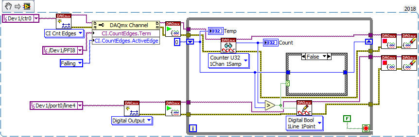

Hi GerdW,
Thank you for the things you said very interesting. The algorithm that uses local variables as I did before is due to thinking like the previous C/Arduino programming language I used. As you said, Use the DI signal as a trigger for the second task. I tried searching for example
I don't know if this is an example you want me to find.

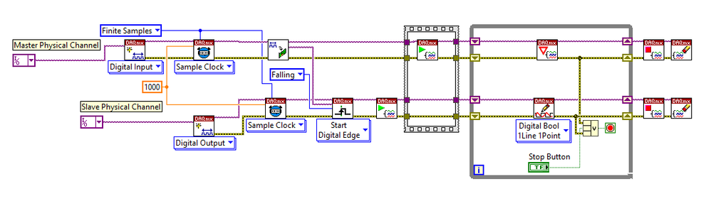

Hi GerdW,
I just wrote an example, you can help me see if it works properly: "when the Master Channel has an  Input pulse from high to low, the Slave Channel has an output pulse from a low level to a high level." Thank you.

Hi hung,
you don't need that "master" task.
All you need is to set the correct (PFI) channel for this DAQmxTrigger…
I have been studying labview for 2 days, I see examples that are too difficult. Thanks you!
That's why there is a "Training" section in the header of thisLabVIEW board.
You really should take that!
You want to cope with DAQ hardware, so you better do some training before starting to code…
