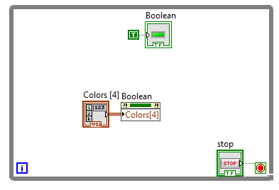

change the color of square LED boolean
As title, I want the color of off form is transparent, but it does not display as my expectation.
I also tried to use color 4 of property node, but I fail.
How can I change the color? Can anyone help me?

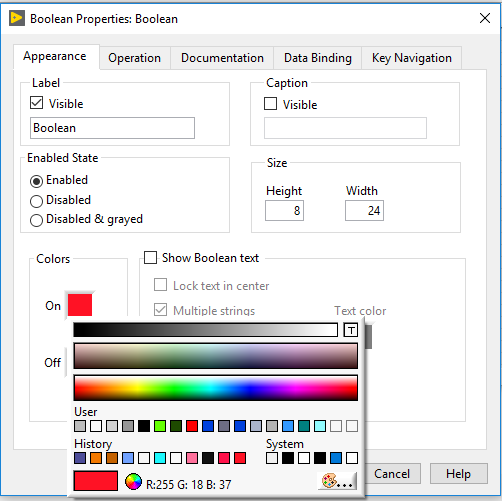

hi ,
You can change the color buy two Methods :
1 : using color [4]
2 :  using Properties
Message 3 of 13

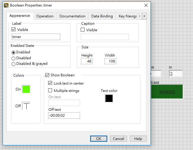

ufaruque123, Emna20 thanx for your responses!
Strangely, when I select transparent, the color become dark green in this boolean.
Besides,I expect that I can change the dark green to transparent.
Furthermore, in this case,I want to change the dark green to white without special effects.

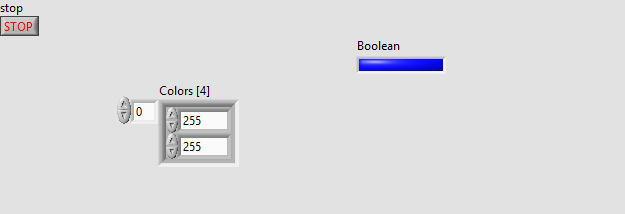

hi antinhia ,
chek this vi ;
Kudos are welcome .

You are using LabVIEW 2014.  This appears to be a bug for this control -- it appears to have been fixed by LabVIEW 2016 (the oldest system I currently have readily "at hand").  "Transparent" really isn't a color (it is a special value that LabVIEW "catches" and handles, but apparently the code was not implemented for Square LEDs at some point, including LabVIEW 2014).
Upgrade your version of LabVIEW and this problem should go away.

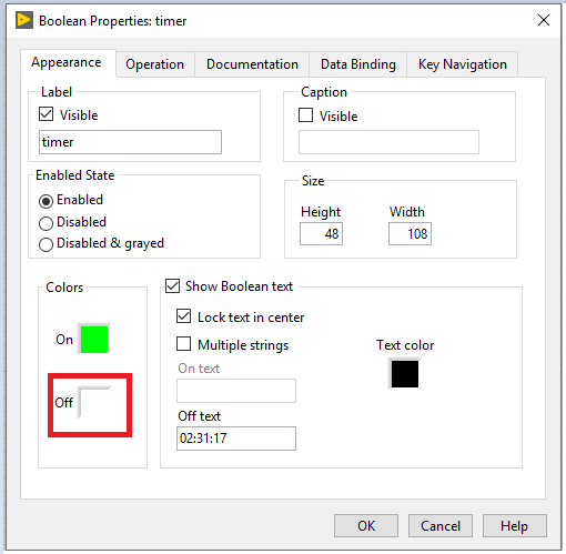

hi ;
if you want to change the color of the square LED from dark green to white  you have to use properties (colors : off) .

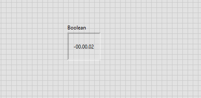

Hi antinhia,
It looks like you have applied the color directly to the control.
You can fix by either of method,
Right click on the control and go to Visible Items--> Decal and un-check it
or
Select the paint brush and click it on the border of Boolean indicator(You can move the cursor at different part and observer the color) and set it as transparent
Or create a new control and don't apply the color on Boolean indicator using Tools (set color), set the on\off color using indicator properties as mentioned in another reply.

thanx you a lot Emna20!
yeah I know that I can change the color through Properties.
My ideal is the booleam only displays pure white without any special effect.
thanx Bob Schor! this is such a tangled bug, now I ignore it.
