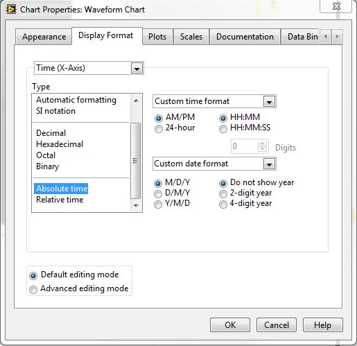

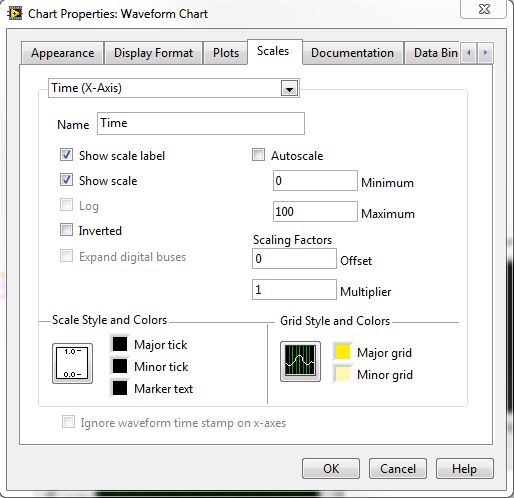

I wanted to let you know that most of this can be configured be the properties window accessed by right-clicking on the chart. Here are a couple screenshots that show locations of your requested modifications.
In order to change the length of time plotted by the chart, you can select "chart history length" from that same right-click menu.

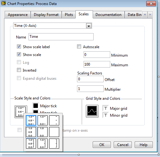

are you sure you have the x-axis selected.  Show a snip of the property page or attach the offending chart in a new vi
