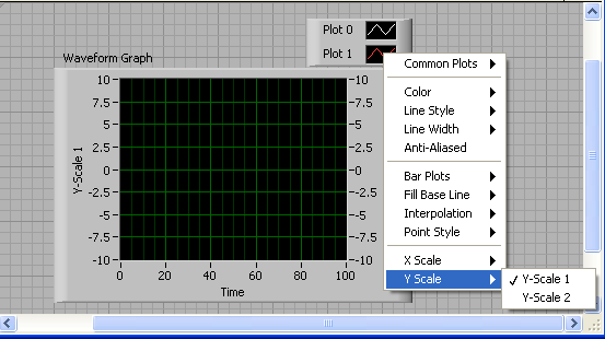

You can also select the scale(s) to use while running by right-clicking the plot in the legend and selecting from the menu.
And, as you can see from the menu you can modify many other characteristics of the plots from this same menu.
