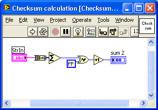

This is the programme i am using now, but the calculation result is not right when i type 04DI\s\s in the string the result is not CF

replace your XOr with a subtract node then swap the two inputs to the subtract node.
Note:
THe for loop will auto indedx the array if you let it.
Or you could
String >>> String to byte array >>> Sum Array elements >>> XOr with "FF" then add 1.
20617i815FCDF516A93822
Ben

Ben
  i have replace the XOR node to sustract node, but it does not works, the result still wrong
Message 8 of 14
(10,312 Views)
So now I play a guessing game...
Did you swap the two inputs to the subtract as I posted?
It worked for me so please try to bait that hook again and again post an IMAGE (down loading on one machine and transfering to another just to look!).
Ben
Message 9 of 14
(10,299 Views)
HI
  i think i get the right reslut, this is the right VI
Message 10 of 14
