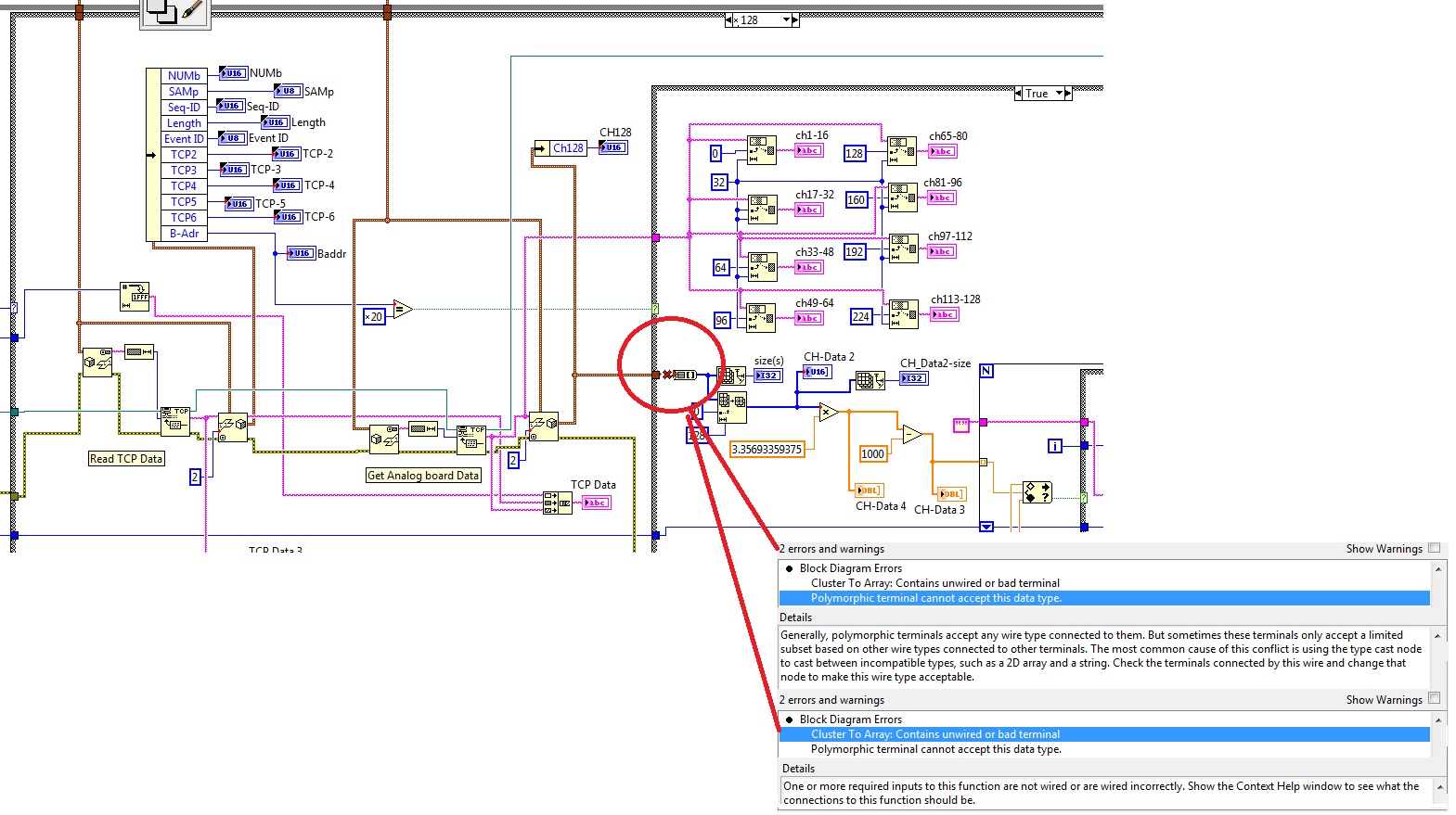

I am sending commands to a device and reading TCP data.
Without getting into a lot of details, that data is 128 channels that is hexidecimal, little endian two compliment,.
and I want to display all 128 channels of data on the front panel (16 channels per indicator).
In my attached VI I am showng the raw data in these indicators but really want to show the calculated values.
I had set the clusters for analog data up for U16 data types but converted these over to I16  data types.
The calculations that I want to perform on each channel of data is to convert to 2's compliment and then multiple
that number by 3.3569335975 (adc bit value) and then subtract a correction factor of 1000.
I know that my VI is over complicated and can be done much simpler but with the time crunch that I have, there may not be enough time to rewrite the whole thing.
Not sure if I need the CH1 - Ch128 in the Analog data cluster to be data types I16 in order to do 2's compliment (signed data vaues)
but when I converted these over from U16, the following errors occurred but I am not sure why:

All of the data in your cluster must be of the same type.
But looking at your code, I don't see a reason for the cluster.  You could just have the TCP Read read X*2 bytes (X being the number of elements in your array) and then use Unflatten From String to straight to your array of I16.

Since all your inner elements are of the same basic type, you could possibly just typecast the cluster to an I16 array. See if that works.
