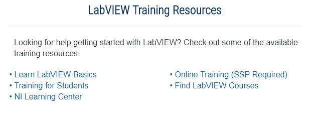

On the first page of the LabVIEW Forums, you'll see this:
Click on the first Link, and review the first 5-6 lessons (actually, you should review all of them, it won't take much time).  All of the (elementary) concepts I discussed are presented here, and you should try them for yourself and write some very simple code to create simple arrays, combine two 1D arrays into a 2D array, see what happens if you take a 5-element array and combine it with a 10-element array to make a 2D array, create a cluster, create a cluster of two 1D arrays, etc.
