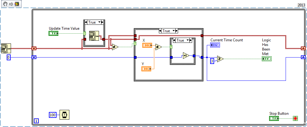

Data is being generated by a controller. Everytime that data updates, the time when it updated is shown in a timestamp.

Look at this. I hope this isn't homework. It could be done cleaner, but this will give you an idea.

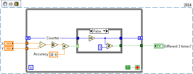

Do you need to do it by feeding in timestamps? Why not just run it right next to where your data pops out?

Yes Gregory I need to use the timestamp...
With a minor change from Patrick's test VI, I was able to get the solution I was looking for.

You shouldn't put your x and y controls inside the case.
Glad to answer questions. Thanks for any KUDOS or marked solutions 😉
Message 19 of 21
(2,279 Views)
By the way, this snippet I showed would be part of a larger code, so the X and Y variables inside the case structure would be local variables. Is that OK?
