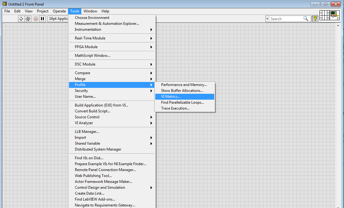

Hi Sean J,
The tools in LabVIEW under Tools>Profile might help you.
