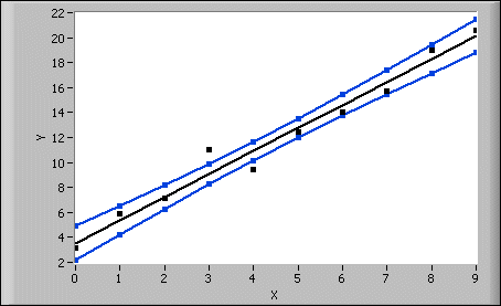

For example, if the data was all over the place (a scatter plot, for example) and the 'Linear Fit.vi' was used for it, it will come up with some sort of line graph that will be 'closest' to all of the data.  This equation will have a y-intercept, and a slope.  For example purposes, lets say the equation is:  Y = 6x+3.  This means that the slope is 6 and it crosses the Y axis (X=0) at 3.  This will line up the 'best' with the data provided.  But, we are wanting to compute the Confidence Interval, which is the range in which 95% of the data will reside.  If the 'delta slope' was 1.4, and the 'delta intercept' was .6 then the resulting 'range' will essentially be:
Y = 6 (+/- 1.4) * x + 3 (+/-) .6
Which would yield in a graph which would look similar to the following:
Where the 'Black' line is the 'Linear Fit' for the data (scatter plot) and the two 'Blue' curved lines make up the 'range' or the Confidence Interval for the data.
This data is acquired by some fairly intense mathematics, and here are a few references with some equations:
