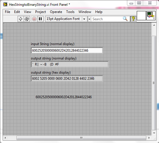

hi,
im using this .vi to convert the hexadecimal string. the weird thing is my friend also used the same vi but he get different answer and the answer is what we suppose to get. the number i used is 60025205000006002D42012844022346. my result as below.

It is not clear what you mean.
What's wrong with the result shown? What result do you actually want?

suppose i get below answer when the barcode being scan.
"r%  & Mb!Hd"Cf
Message 7 of 25
(25,777 Views)
and im using labview 12.0. is it because of the version?
"r%  & Mb!Hd"Cf
Suppose what?  Can you give a more complete description as to what is right and what is wrong?
For the string you posted above, the hex characters would be.
2272 2520 2026 204D 6221 4864 2243 66
That doesn't look anything like the string of hex characters you posted in the earlier message.
And I'm sure that it has absolutely nothing to do with what version of LabVIEW you are using.

Thanks RavensFan,
the value u posted are the one im searching for.
right now im like assemble the puzzle pieces.no direct infor.can u show me how u convert from the value i gave to the one u posted above?
