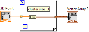

Is there an easy way to convert a 2D array of clusters (3 elements) to a 1D array of cluster of 3 elements? I need to do this in order to store my large data to be compatible as this data type . as the attached vi , convert "3d point" that is 2d array to 1d array of cluster of 3 elements as "vertex array"

i used the reshape array as attached , but the result is 1D array of cluster with 1 element , I need a 1D array of cluster with 3 elements. any idea please??

Your input is a 2D array with three columns (no clusters!), so all you need is the following:
