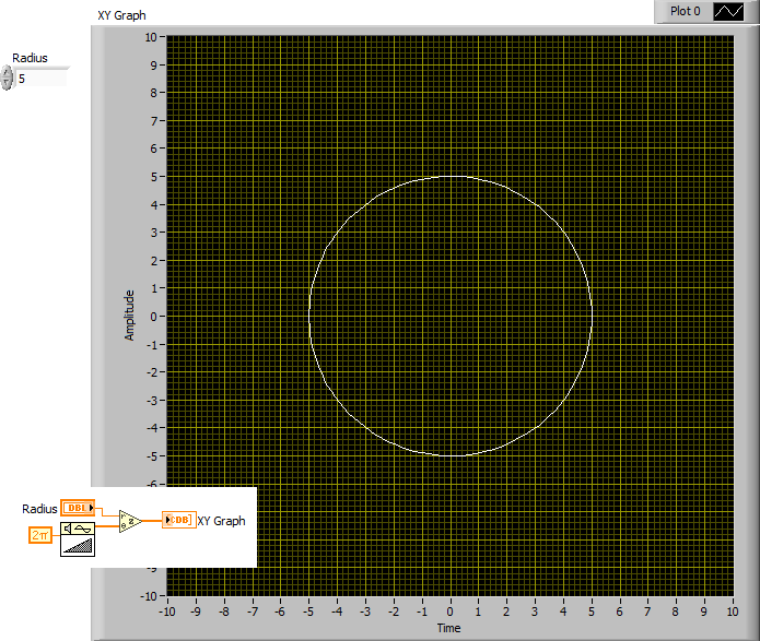

If complex data is allowed, all you probably needs is the following:
Message 2 of 12
(452 Views)
or alternatively something like this, maybe:
Message 3 of 12
(441 Views)

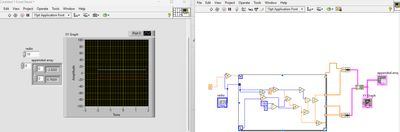

I love you very much, I started to base myself on your code to make it in the form of a block diagram since I was asked to do it that way and not with code or something else that makes it much easier. I am already making progress, you have helped me a lot.
but as you can see I'm still missing

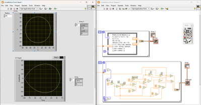

You still did not do a "save for previous", But try something like this...
Message 5 of 12
(418 Views)
Try this way:
Message 6 of 12
(413 Views)

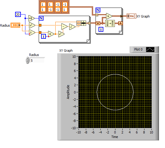

Technically, you can avoid this if you compute the upper and lower halves of the circle in a single for loop, something like this:

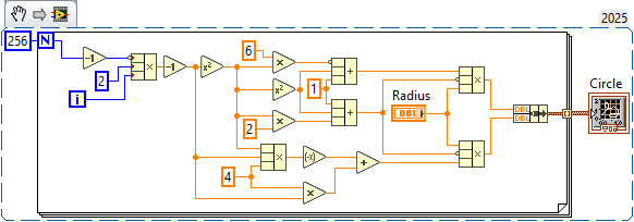

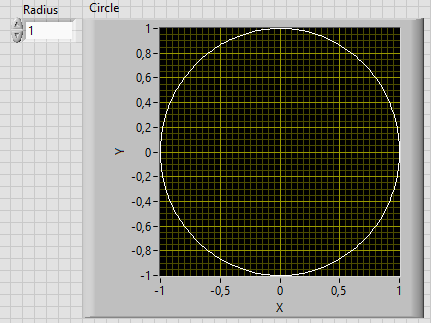

I would even do a loop free solution.
I still strongly prefer my first suggestion because the circle is guaranteed to close and the points are evenly distributed around the circumference.
Attached are both versions.
