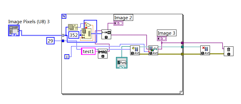

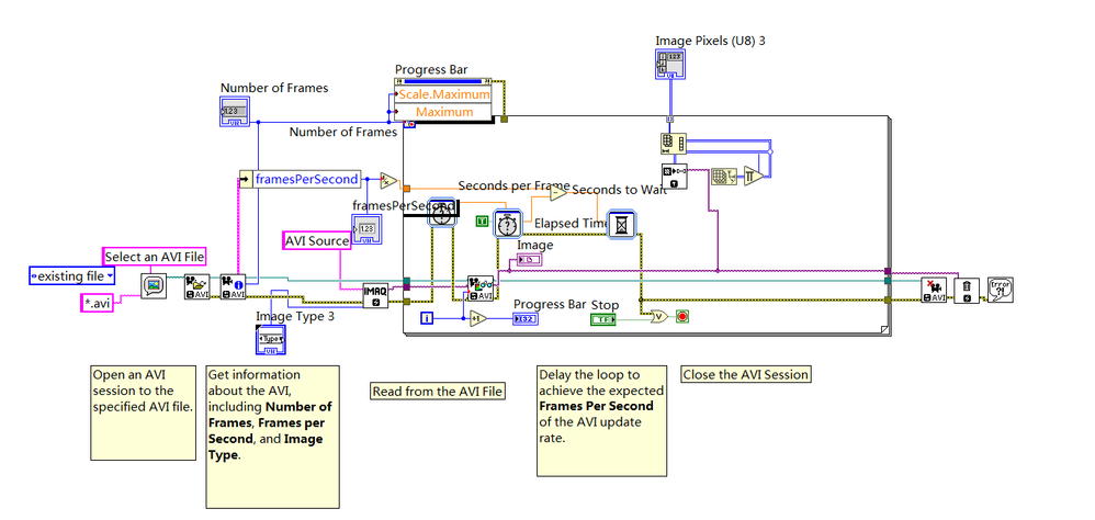

Kudos! Probably I did not describe it clearly causing you to have misunderstanding.FIG 1FIG 1like the Fig 1,finally I got a pixels array from the file.avi, and I want to recover the vido by pixels array,just like Fig 2,but my program doesn't work.So could you help me? Thanks!!Fig 2Fig 2

Your opening a new AVI in every iteration of the for loop. The open should be in front of the for loop. Use a shift register to pass the AVI reference through the loop (or the output will be invalid if N=0).
