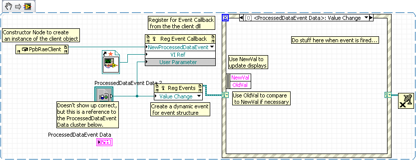

I had to figure this out for the .NET side of things.  It may help, not sure.
I started by creating an instance of the client object seen below.  In that client object there is an event that tells users when new data is available to be displayed.  To subscribe to that event I register for the Event callback from that object.  There is a lot more on this in the NI example finder if you search for NET Event Callback for Calendar Control.  This is where I learned how to do most of this.  I had to create a separate VI for the VI Ref and wired up a Reference to the data cluster as the user parameter.  Next I create a dynamic event for that data cluster.  If the value changes I want the event structure to do something for me.  I use the NewVal and OldVal for comparison.  At this point my front panel display is updated with any new information.
I am not sure if this will help but I know what it was like trying to figure out how to use an event from a DLL to trigger my LabVIEW VI.  Let me know if this helped or if you need me to clarify anything.

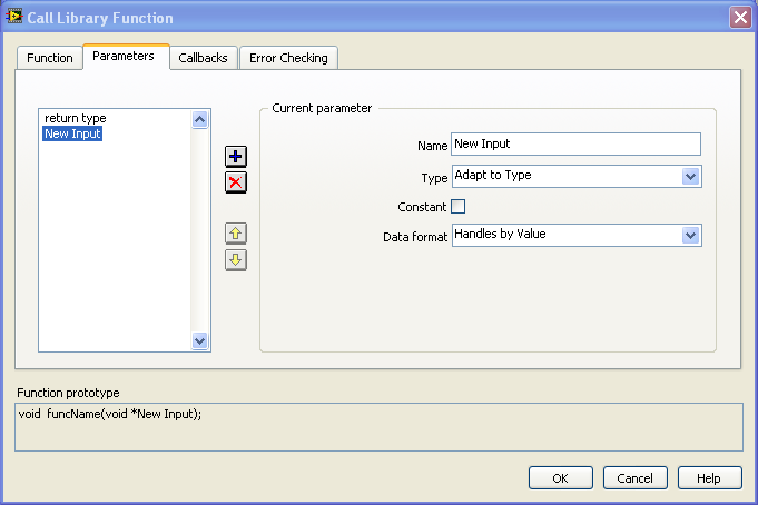

Which function are using currently using to "import the function". You should be able to confiure the LabVIEW interface to your DLL in the Call Library Function Node. If you need to add additional functions or paramaters just use the properties menu to add the new items.

I imported the wrapper dll and created VIs for each of the functions.  Now I need to add a parameter to the wrapper dll function.  The parameter I need to add will be a cluster array (I think) because in the warpper dll I need to convert this to/from an array of structures for the API dll.  I can figure out how to modify the wrapper dll, but I don't know how to add the parameter in Call Library Function because it's a cluster array. I also need to create the cluster array and I'm lost on that one.
