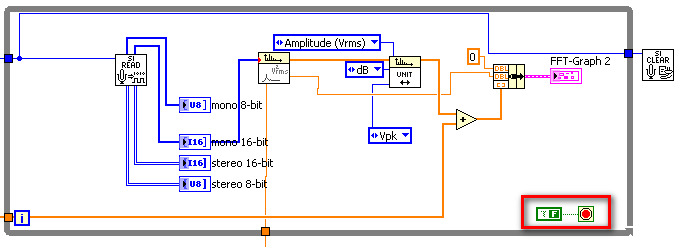

The example from MarianMO was somewhat confusing for your need. Even if it is step in the correct direction. Take a look at my half done mod of your program. You have to add the scaling functions. Also reading the sound buffer once every second should be more than good enough. Read this also http://zone.ni.com/devzone/cda/tut/p/id/4278
By the way running a Labview program with the continuous run button is a NO CAN'T DO. This function is for debugging only. Use a while loop like I did
I think this should work but I have not testet it;)

thanks for your clarification, but I am a bit confused about the constant at the while-loop:

My example was just meant as a push in the correct direction, or a casting frame for further programming. I am sure the honourable Alesis will be able to work on the minor details;)

My example had a few faults. Then you use the "SI Read.vi" the number of samples is equal to buffer/2. I did not know that. The rest is up to you.

I looked at your(my) VI ;). I will recommend that you do not use any window function. Also if you want things correct you must use the magnitude(peak) option. I do not quite understand what your trouble are now. Can you give a better explanation.

Also i did not see this one because I do not use Express VIs. But it is good example of a typical express VI trap. Bottom line do not use them. They actually makes a beginner struggle more. Well anyway, you must use the Build Waveform (Analog Waveform) Function. Owning Palette: Analog Waveform VIs and Function. So you get the correct dt into the FFT Express VI. Why did you change the setting that was working correct whit standard VIs?
Also a tip. Then you are programming you MUST keep attention to details. You can not just toss in some functions and hope every thing is correct. Every time you use a filter or spectrum function you must provide some information about the sample rate or dt(1/Fs)
