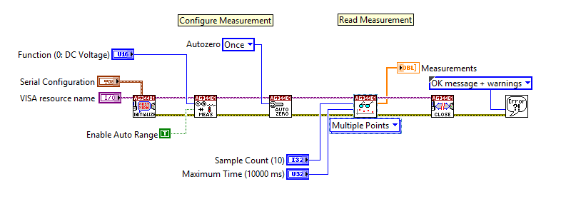

Just one more question. Here is standard example measurement VI which I found. How do I choose the right channel which measures this? Not one of those blocks contained option to choose channel? Checked also "acquire and chart triggered", example and failed to find also a channel to choose there. What am I missing here?

The NI U2300 series drivers should support the U2355A, as per the link.
Have you added the code to a project which also has your hardware added for the VISA Resource Name? Maybe try looking in the relevant function palette for a VI which allows channel selection? Where did you find the example measurement VI, and is it for the Agilent Technologies / Keysight Technologies drivers?

It was in the 2300-series folder. This driver I have downloaded allready. I am just struggling to get started and to find logic behind some of these options.
For example. I found a "series digital output", example vi. I can choose those DO channels between 501 and 504, AI:s are defaults as 101 -> but these can be changed, whereas AO:s there is 201 and 202 to choose from.

The examples may be for different hardware, such as the U2331A for example. If you refer to the documentation you have for the U2355A, you should be able to see the IO for your hardware in the channel selections.

Oh, I was looking at totally wrong part of manual!! Sorry all and thanks for replying.
