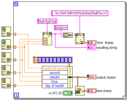

I attached some images from my excel file and my code.

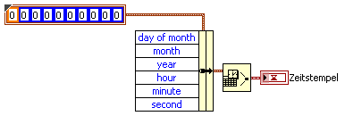

Once you have read your data from Excel worksheet you can convert it to LabVIEW timestamp:
You can configure the display format of the timestamp to your needs…

Hi Gerdw:
I tried that solution, but the problem is that the data from excel is being save in arrays of double 64 bits, when I create the cluster, the program indicate an error.
The type of the source is 2-D array of
    double [64-bit real (~15 digit precision)].
The type of the sink is double [64-bit real (~15 digit precision)].

I attached the vi and one excel example.
In this case, I obtained a Cluster with fractional seconds, secondd, minutes and hours but I did not obtain the time stamp.
In the Data/time to seconds appears a red point, Can someone explain me what it means?.
Thanks for your help.

Hi buton,
your FOR loop can be cleaned up to this:
- Why don't you use IndexArray before the loop to index the needed row? (For columns you need to wire a constant.)
- Why do you convert your data to a matrix to be able to index the upper left element? Why not use IndexArray instead?
- Why do you convert numbers to strings to be able to use FormatIntoString? Why not do all with FIS?
- Your concatenation of a full date & time string will only work for US-american regional settings…
- Why not put all relevant data (including day, month, year) into the timedate record?
Addition:
- By moving the indicators outside the loop you will receive arrays of timestamps. Seems more appropriate when reading full columns from Excel…

@GerW
The loop was already there when i opened the file.. i just helped him with the date thing.
theres a lot of improvement that could be done to that loop. and GerW  you did a great job explaining and redoing the code 🙂
