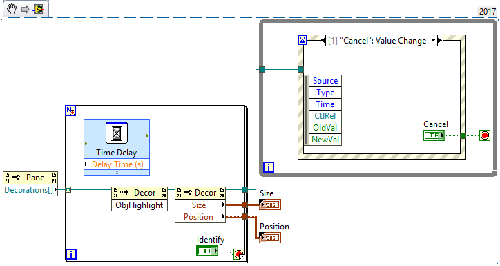

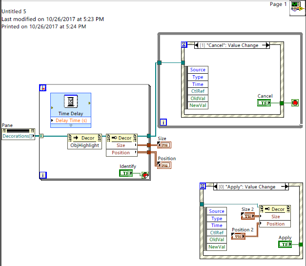

And more
Replace the Pane Property node with a ref to the pane of the vi containing the decoration you want to resize (likely by vi path and open vi reference)
Run the code.  When the correct decoration blinks hit "Identify" then enter the new size and location hit Apply to Apply or Cancel to Cancel.
Decorations have no label so you need to identify them some other waySmiley Wink
Clean it up your own self Smiley LOL
