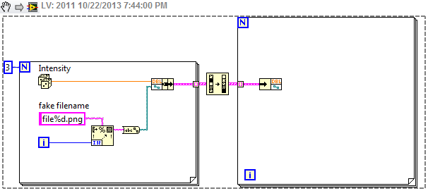

I have developed a VI that says which image is the lowes intensity among the 3 images in a given folder.
  1. How can I automatically delete that image from the folder and rename the other two as Image 1 and Image 2 ?
  2. If the deleted image orginally is 2nd image in the folder , I want the 3rd image to renamed as 1 and the 1st image to renamed as 2.
  3. If the deleted image orginally is 1st image in the folder , I want the 2nd image to renamed as 1 and the 3rd image to renamed as 2.
  4. If the deleted image orginally is 3rd image in the folder , I want the 1st image to renamed as 1 and the 2nd image to renamed as 2.
Basically its a rolling sequence, where the deleted image is always considered the last in the series and the images that are in the folder are not in the correct sequence.
How can I achieve this efficiently.

You could bundle the intensity with the filename (intensity as the first element), sort 1d array, then rename and delete files as necessary:
