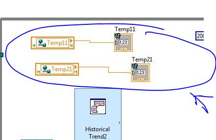

So let me try to understand: your subVI should write the values to the Temp11 and Temp21 in the subVI front panel and at the same time, the indicator for Temp11 and Temp21 in your main VI should read the change as well?
From what I see from your code, I do not see anything which writes to the shared variable as they are all reading from the shared variables Temp21 and Temp11 respectively. I did not see anything that is written to those shared variable. Second, the shared variables in your main VI is not in the loop and therefore they are updated once (from what I can see from the screenshot below)

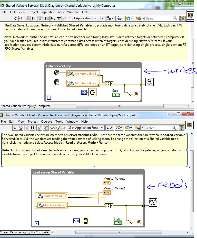

In order to tranfer data from 1 VI to another using Shared Variable, the subVI has to write to the shared variable while at the main VI, it reads from the shared variable. The example is shown at the below screenshot which was taken from the example "Shared Variable.lvproj" which I have mentioned in my previous post (to make a shared variable to write, right click on the shared variable >> Access Mode >> Write):

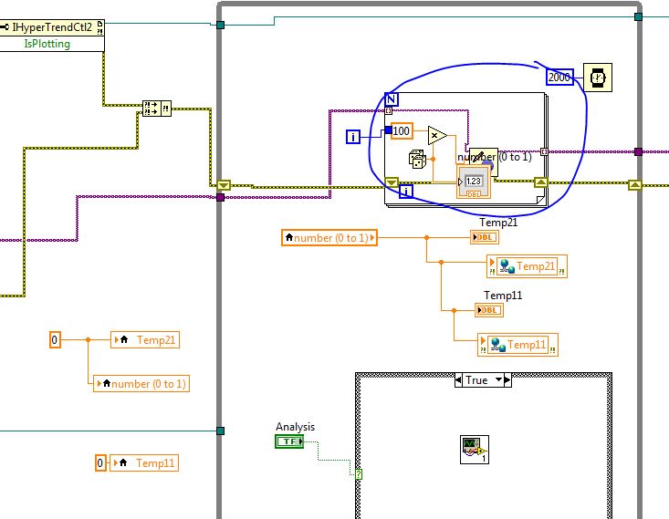

At the main VI (Temp_TSC.vi), pressuming that the random number is the one circled below:
Have you tried to change the code like as the screenshot above? Since I am transfering data from the main Vi to the subVI using shared variable. Outside the while loop, I write to number (0 to 1) as 0 which in turn writes the value 0 to the Temp 21 and Temp 11 indicators and shared variables since anything outside the while loop runs once. After that, as the code progresses, every changes in the random number that is written to the number (0 to 1) indicator is written to Temp 21 and Temp 11 indicators and shared variables. That values stored in the shared variables is then transferred to the subVI
