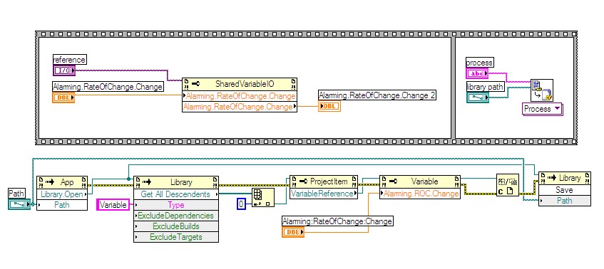

Thanks for the observation -- it looks like this is a bug dealing with the naming of the property by the property node.  This was reported to R&D (# 46IE9SG0) for further investigation.  A workaround is to deploy a library so it become an online process, then use the SharedVariableIO class to programmatically change the desired properties, then use the Save to Library VI that ships with the DSC module.  The following screenshot shows the two methods, the upper method is the workaround (note that you don't need to read back the property like in the screenshot, I was just testing), the lower method is the way that isn't working for these two properties, which doesn't use the online process.  Thanks for the feedback!

It is true that the property names in the Multiple Variable Editor show up differently than the properties when using the SharedVariableIO class properties, but in this case when you set the properties, they are actually getting updated to a different alarm level value, but if you look at the alarm in the Alarm and Event Viewer, it will still reflect the old alarm level value, even though the alarm was actually triggered using the newly set alarm level.
A workaround is to save the Library as shown previously, but also undeploy then redeploy the library -- this will cause the alarm level to display correctly in the Alarms and Events viewer as well as in the multiple variable editor.
