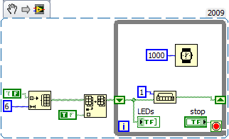

Hi sky,
you just need to output that array using DAQmx functions:

Hi sky,
did you notice the snippet I attached yesterday? It shows how to use an array to hold the status of 6 LEDs in just one wire…
You should do the same with your VI. Handling each single DO in it's own loop is pure overkill - some might say RubeGoldberg! DAQmx can handle more than one DO per task, so give it a try…

Hi sky,
instead of hardcoding each and every delay between the channels you should think about a simple state machine approach:
Have one state for the delay and another state(s) for switching the outputs…
Do you maybe have a VI of the snippet you attached?
Just copy the snippet to your harddisc, then drag&drop it into your block diagram. That's how snippets work…
And how can I use to output it to the digital channels ?
You just output the "LED" array with DAQmxWrite…
